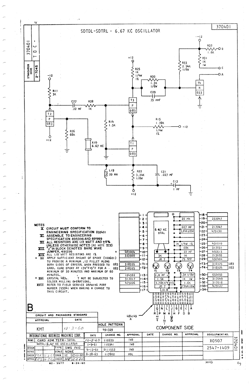

SDTDL-SDTRL- 6.67 KC Oscillator
SDTDL sdtrl 6.61 kc oscillator
Saturated Drift Transistor Resistor Logic (SDTRL) is a form of resistor-transistor logic using faster drift-field transistors.
Part number:370401
Field replacement part number:370401
Customer Eng reference number:729941
PCB number:484149
Used in:IBM 1401,IBM 1410
