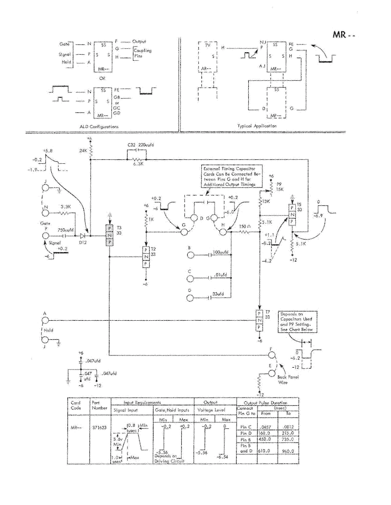

Voltage Mode Single Shot 2
Ctrl-vm single shot #2
Complemented Transistor Resistor Logic (CTRL) is IBM's term for a form of resistor-transistor logic.
Part number:371623
Used in:IBM 1410
Symbol:SS
SS: Single Shot. Provides a monostable output which can be pulsed into its quasi-stable state for a predetermined duration. with each input triggering pulse or triggering voltage change. Once triggered, the output pulse duration becomes independent of input time duration or amplitude.
