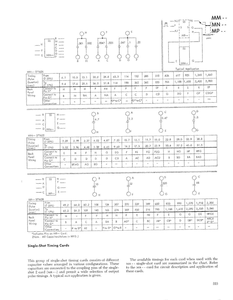

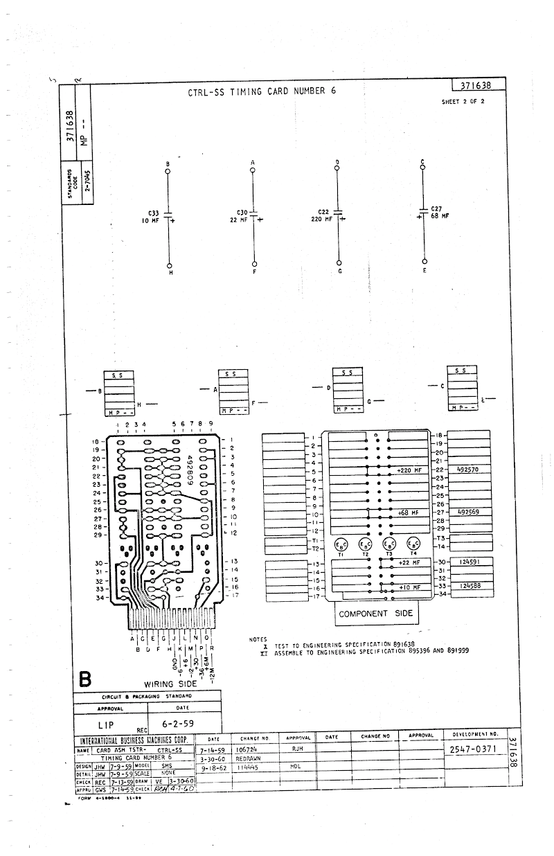

Single Shot Timing Card 6
Ctrl-ss timing card #6
Ctrl-ss timing card number 6
Complemented Transistor Resistor Logic (CTRL) is IBM's term for a form of resistor-transistor logic.
Part number:371638
Used in:IBM 1414 I/O Synchronizer,IBM 1410
Symbol:SS
SS: Single Shot. Provides a monostable output which can be pulsed into its quasi-stable state for a predetermined duration. with each input triggering pulse or triggering voltage change. Once triggered, the output pulse duration becomes independent of input time duration or amplitude.
IBM Standard Modular System, Component Circuits, p223.
1410_SMS_VOL_1.pdf/1410_SMS_VOL_2.pdf, p2102.
1414 SMS Cards, p72.
