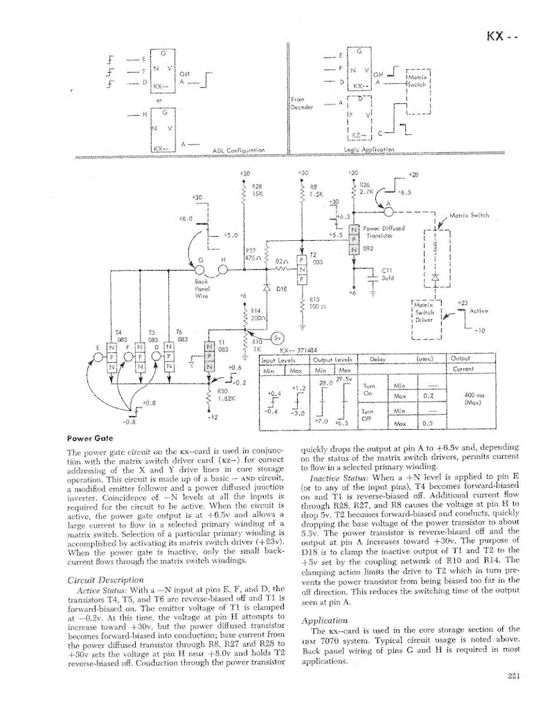

This page describes the IBM SMS card "KX", and is part of the SMS card database.
Power Gate
Part number:371484
Symbol:G
G: Gate. Provides a switching pulse of voltage or current, positive or negative, that conditions some other circuit so that it may become either activated or deactivated by one or more other pulses.
IBM Standard Modular System, Component Circuits, p221.
