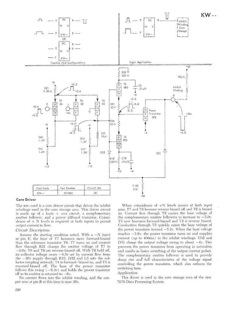

This page describes the IBM SMS card "KW", and is part of the SMS card database.
Core Driver
Part number:371483
Symbol:DC
DC: Driver Core. Same as D, with the device being driven identified as a core.
IBM Standard Modular System, Component Circuits, p220.
