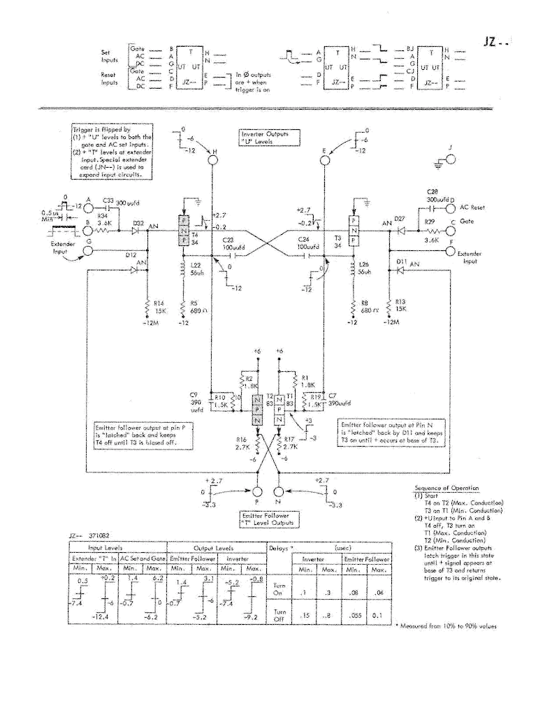

This page describes the IBM SMS card "JZ", and is part of the SMS card database.
CTDL-Trigger No 2
CTDL Trigger 2
Part number:371082
Field replacement part number:371082
Customer Eng reference number:729882
Symbol:T
T: Trigger. A conditioned bi-stable device whose steady-state outputs change from one stable state to the other with two separate triggering levels, pulses, or voltage changes. The set input turns the trigger on if the reset input Is not on, and vice versa.
Family: CTDL high speed
JZ JZ
IBM Standard Modular System, Component Circuits, p164,165.
2_2 SMS Cards, p39,40.
