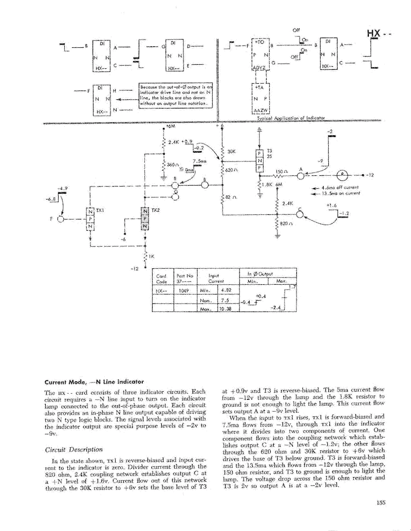

This page describes the IBM SMS card "HX", and is part of the SMS card database.
Current Mode, Minus N Line Indicator
Part number:371049
Symbol:DI
DI: Driver, Indicator. Driver operating into an indicating device.
IBM Standard Modular System, Component Circuits, p155.
