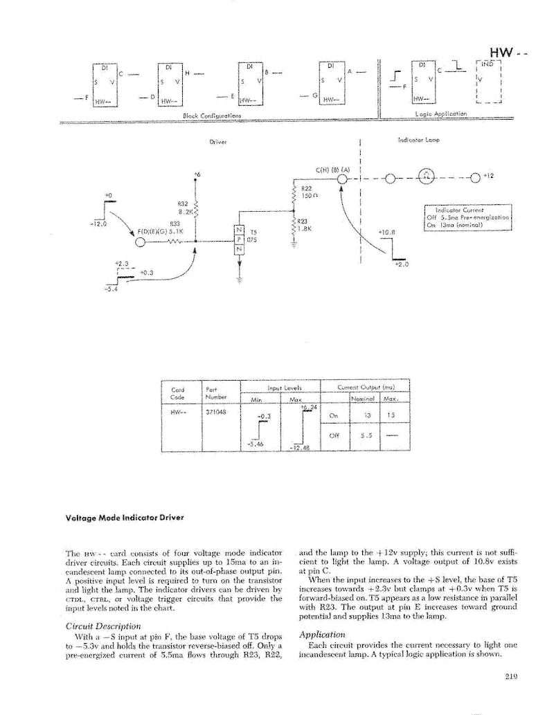

This page describes the IBM SMS card "HW", and is part of the SMS card database.
Voltage Mode Indicator Driver
Alloy-Indicators, Lamp, VM
Germanium alloy transistors were an early type of transistor, faster than the earlier grown-junction transistors.
Part number:371048
Used in:IBM 729V,IBM 1410
Symbol:DI
DI: Driver, Indicator. Driver operating into an indicating device.
IBM Standard Modular System, Component Circuits, p219.
1410_SMS_VOL_1.pdf/1410_SMS_VOL_2.pdf, p2061.
