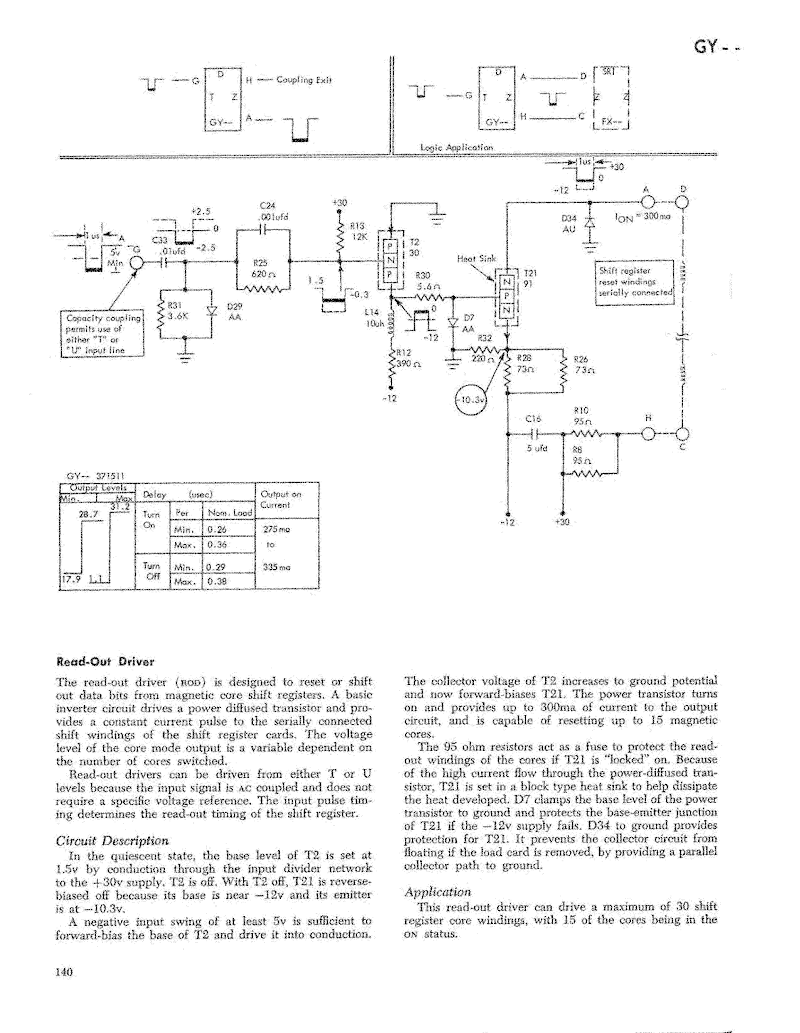

This page describes the IBM SMS card "GY", and is part of the SMS card database.
Magnetic Core Read-Out Driver
Part number:371511
Symbol:D
D: Driver. Isolates a signal from its generating source and uses it to drive one or more other circuits without affecting or overloading the generating circuits. Can be used to supply the required power directly or only to activate the circuit through which power is actually supplied.
IBM Standard Modular System, Component Circuits, p140.
