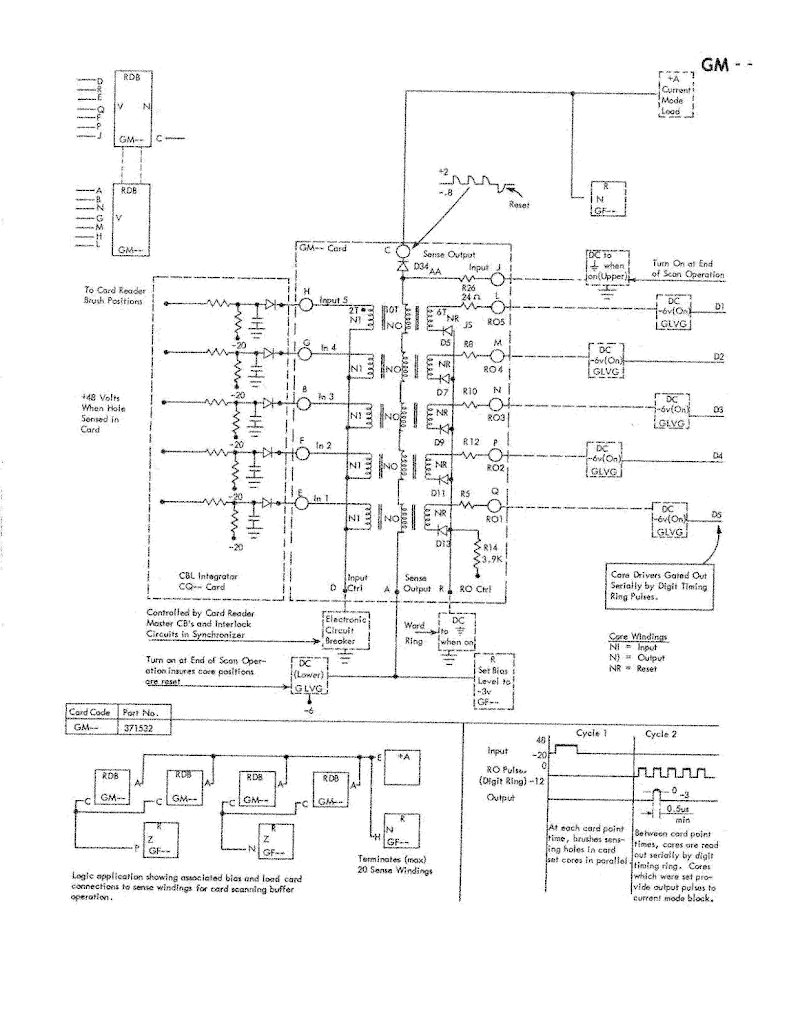

Input Output Core Card No. 1
Part number:371532
Symbol:RDB
RDB: Read Buffer Core. Used as card scanning buffer between card reader and central processing unit.
IBM Standard Modular System, Component Circuits, p126,127.
