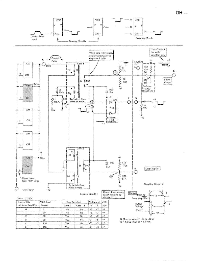

Two of Five Validity Check Circuit
Part number:371504
Symbol:VCK
VCK: Validity Check. Used for checking information bits in the 2-of-5 bit code system.
