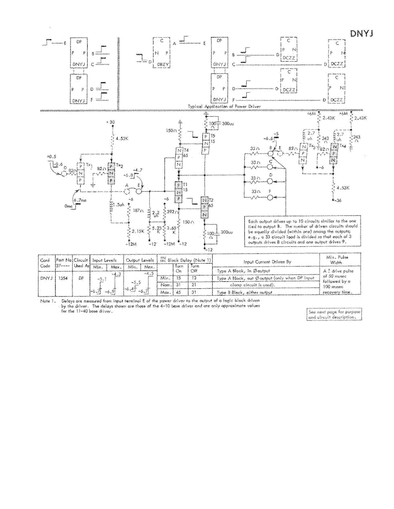

This page describes the IBM SMS card "DNYJ", and is part of the SMS card database.
P to P Power Driver (11-40 Bases)
Part number:371354
Symbol:DP
DP: Driver, Power. A power driver used to drive Into multiple bases.
IBM Standard Modular System, Component Circuits, p95,96.
