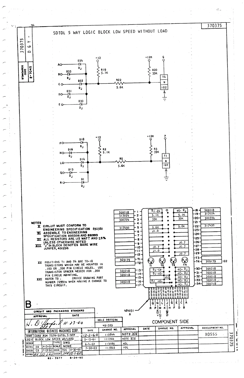

This page describes the IBM SMS card "DGY", and is part of the SMS card database.
SDTDL-5 Way Logic Block Low Speed without Loads
SDTDL 5 way logic blck low sp w/o ld
SDTDL 5 way logic block low speed without load
2-5 way-no load
SDTDL 5 way logic blk low sp w/0 ld
Exists in SLT version.
Part number:370375
Field replacement part number:370953
Customer Eng reference number:729918
PCB number:484031
Used in:IBM 1401,IBM 1311 Disk,IBM 1443 Printer,IBM 2821 Control Unit,IBM 1410
2_2 SMS Cards, p91.
1410_SMS_VOL_1.pdf/1410_SMS_VOL_2.pdf, p1099.
IBM 1311 ILD, p124.
IBM 1443 ALD, p99.
IBM 2821 CCD, p55.
