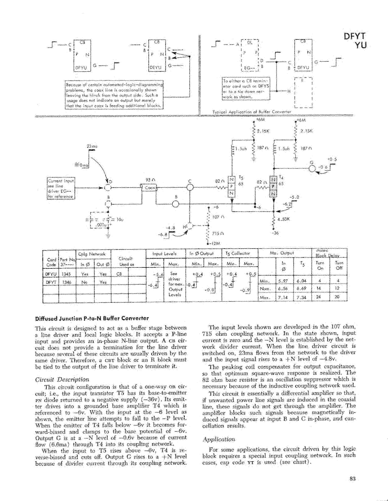

This page describes the IBM SMS card "DFYT", and is part of the SMS card database.
P to N Buffer Converter (out-of- phase load)
Part number:371346
Symbol:CB
CB: Converter Buffer. A converter block that uses the current mode transmission line driver signal sent from a transmitting frame to generate voltage swings referenced to voltage planes of other frames.
IBM Standard Modular System, Component Circuits, p83.
