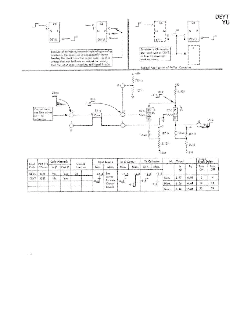

This page describes the IBM SMS card "DEYT", and is part of the SMS card database.
N to P Buffer Converter (out-of- phase load)
Part number:371327
Symbol:CB
CB: Converter Buffer. A converter block that uses the current mode transmission line driver signal sent from a transmitting frame to generate voltage swings referenced to voltage planes of other frames.
IBM Standard Modular System, Component Circuits, p75,76.
