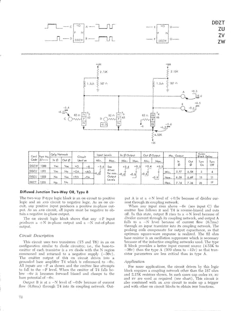

This page describes the IBM SMS card "DDZW", and is part of the SMS card database.
Two-Way OR, Type B (both loads)
Part number:371300
Symbol:+O
+O: Positive OR. In-phase output is positive if one or more input signals are positive. Out-of phase output is negative for the above condition.
IBM Standard Modular System, Component Circuits, p72.
