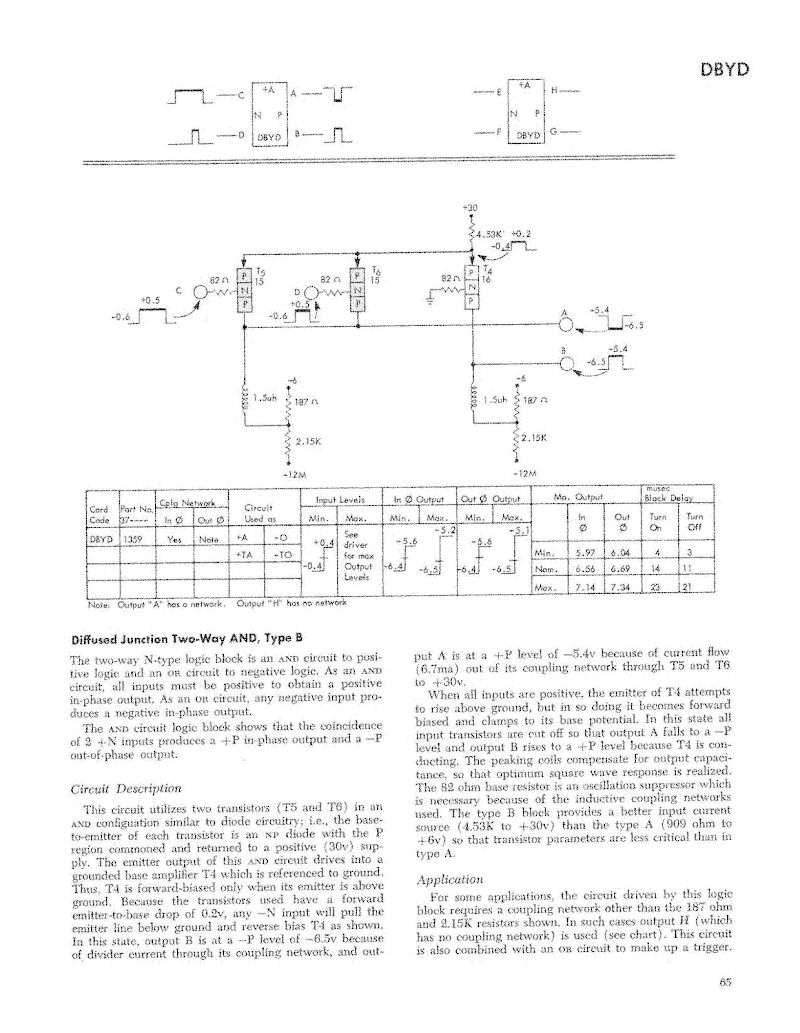

This page describes the IBM SMS card "DBYD", and is part of the SMS card database.
Two-Way AND, Type B (Ckt 1, both loads) (Ckt 2, in-phase load)
Part number:371359
Symbol:+A
IBM Standard Modular System, Component Circuits, p65.
