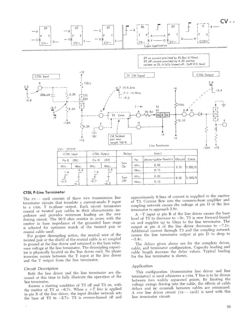

This page describes the IBM SMS card "CV", and is part of the SMS card database.
P Type Line Terminator
Part number:371519
Symbol:DT
DT: Driver. Terminator. A single-transistor class-A grounded-base amplifier used to terminate a transmission line.
IBM Standard Modular System, Component Circuits, p59.
