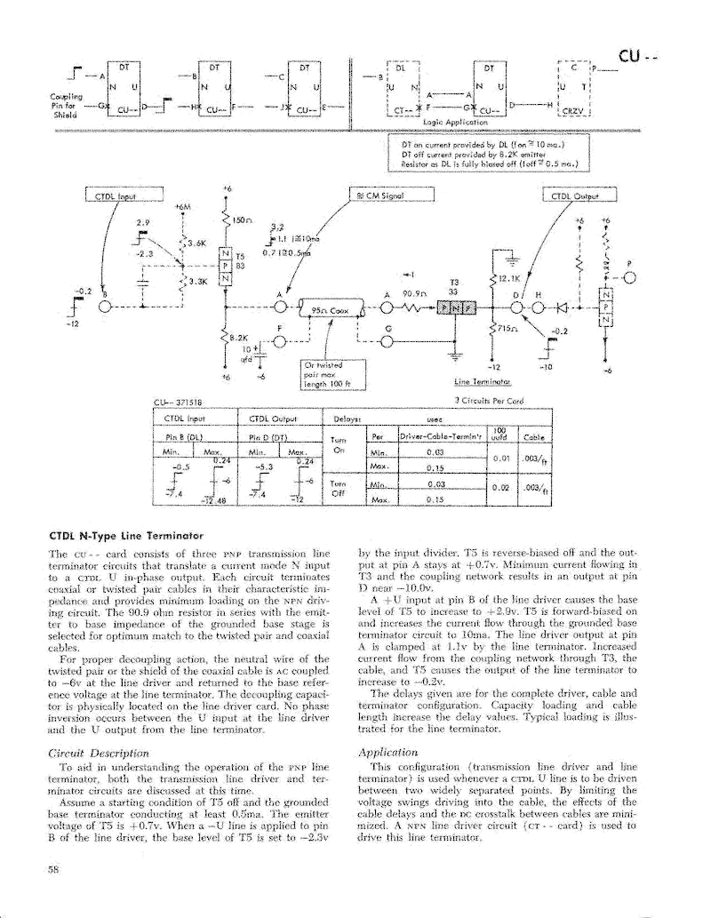

This page describes the IBM SMS card "CU", and is part of the SMS card database.

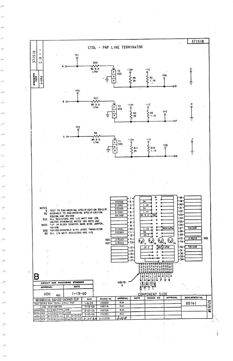

N Type Line Terminator
Ctdl - pnp line terminator
Part number:371518
Used in:IBM 7070,IBM 1410
Symbol:DT
DT: Driver. Terminator. A single-transistor class-A grounded-base amplifier used to terminate a transmission line.
IBM Standard Modular System, Component Circuits, p58.
1410_SMS_VOL_1.pdf/1410_SMS_VOL_2.pdf, p2085.
