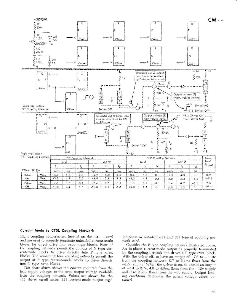

This page describes the IBM SMS card "CM", and is part of the SMS card database.
CTDL-Coupling Network
CM to CTDL Coupling Network
Part number:371256
Field replacement part number:371256
Customer Eng reference number:729840
Used in:IBM 1401,IBM 7070,IBM 1410
Symbol:R
R: Load. Provides proper terminating impedance or optimum coupling of one circuit to another at the correct operating voltage level.
IBM Standard Modular System, Component Circuits, p49.
1_2 SMS Cards, p102.
1410_SMS_VOL_1.pdf/1410_SMS_VOL_2.pdf, p2070.
