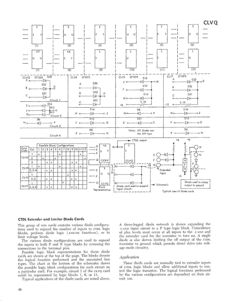

This page describes the IBM SMS card "CLVQ", and is part of the SMS card database.
CTDL-Extender Card
Extender and Limiter Card
Part number:371255
Field replacement part number:370979
Customer Eng reference number:729836
Symbol:E
E: Extender. Provides additional inputs to logical blocks and triggers. Adds to drivers the ability to drive more loads.
CLVQ CLVQ CLVQ CLVQ
IBM Standard Modular System, Component Circuits, p48.
1_2 SMS Cards, p35,98.
1414 SMS Cards, p98.
