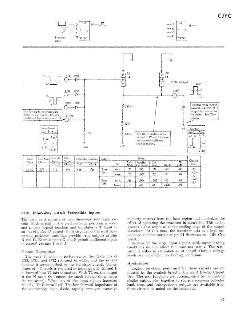

This page describes the IBM SMS card "CJYC", and is part of the SMS card database.
CTDL- 3-Way “And” PNP Extendable Inputs
Three-Way-AND (2 loads) (Ext. In)
Ctdl 3 way and pnp all loads
Part number:371071
Field replacement part number:370977
Customer Eng reference number:729841
Symbol:-A
-A: Negative AND. In-phase output is negative only when all inputs are negative. Out-of-phase output is positive for the above condition.
CJYC CJYC CJYC CJYC
IBM Standard Modular System, Component Circuits, p45.
1_2 SMS Cards, p33,93.
