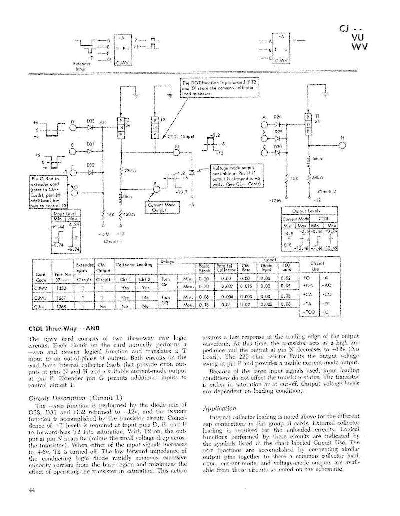

This page describes the IBM SMS card "CJWV", and is part of the SMS card database.
CTDL- 3-Way “And” PNP
Three-Way-AND (2 loads)
Ctdl 3 nay and pnp all loads
Part number:371253
Field replacement part number:370917
Customer Eng reference number:729830
Symbol:-A
-A: Negative AND. In-phase output is negative only when all inputs are negative. Out-of-phase output is positive for the above condition.
CJWV CJWV CJWV CJWV
IBM Standard Modular System, Component Circuits, p44.
1_2 SMS Cards, p33,92.
