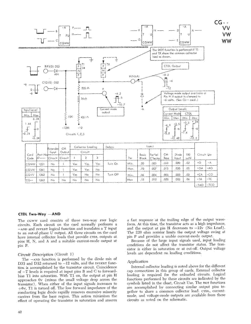

This page describes the IBM SMS card "CG", and is part of the SMS card database.
CTDL-Two Way “And” PNP No Loads
Two-Way-AND (no loads)
Ctdl two way and pnp no loads
Ctdl 2 way and pnp field replacement
Part number:371263
Field replacement part number:370975
Customer Eng reference number:729820
Symbol:-A
-A: Negative AND. In-phase output is negative only when all inputs are negative. Out-of-phase output is positive for the above condition.
CG CG
IBM Standard Modular System, Component Circuits, p42.
1_2 SMS Cards, p29,82.
