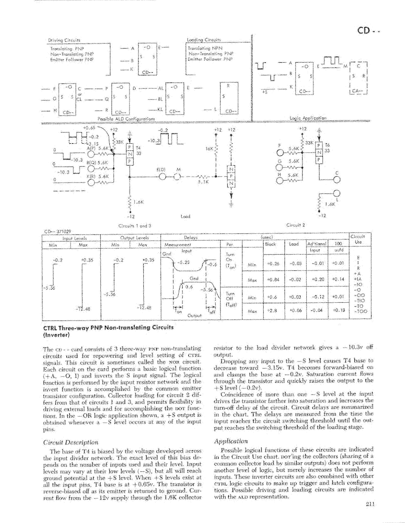

This page describes the IBM SMS card "CD", and is part of the SMS card database.
CTRL-Inverter "N" Type
CTRL Three-Way PNP Non-Translating Circuits
Ctrl-inverters n type
Ctrl - inverters "n" type
Triple 3 Input NAND
Complemented Transistor Resistor Logic (CTRL) is IBM's term for a form of resistor-transistor logic.
Part number:371029
PCB number:491149
Used in:IBM 1620,IBM 1414 I/O Synchronizer,IBM 729V,IBM 1410
Symbol:-O
-O: Negative OR. In-phase output is negative if one or more Input signals are negative. Outof-phase output is positive for the above condition.
Transistor type:033
IBM Standard Modular System, Component Circuits, p211.
1410_SMS_VOL_1.pdf/1410_SMS_VOL_2.pdf, p2055.
1414 SMS Cards, p19.
IBM 1620 Instructional System Diagrams, p475.
Pinout:
A I1
B I1
C O2C
D O3
E O1
F I2
G I2
H I2
J GND
K I1
L O2R
M -12V
N +12VM
P I3
Q I3
R I3
