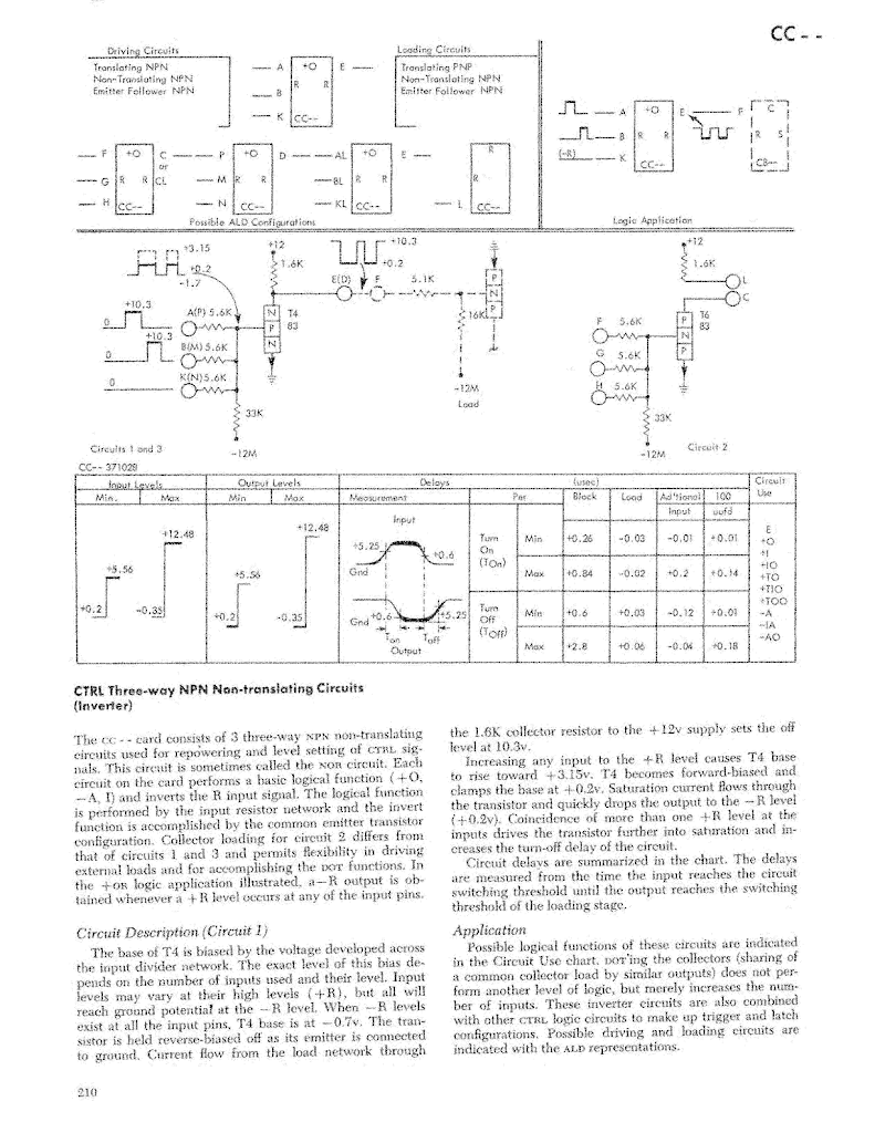

This page describes the IBM SMS card "CC", and is part of the SMS card database.
CTRL Three-Way NPN Non-Translating Circuits
Ctrl - inverters "p" type
Complemented Transistor Resistor Logic (CTRL) is IBM's term for a form of resistor-transistor logic.
Part number:371028
Used in:IBM 1410
Symbol:+O
+O: Positive OR. In-phase output is positive if one or more input signals are positive. Out-of phase output is negative for the above condition.
IBM Standard Modular System, Component Circuits, p210.
1410_SMS_VOL_1.pdf/1410_SMS_VOL_2.pdf, p2054.
