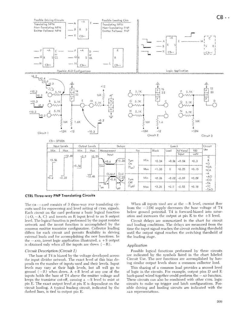

CTRL Three-Way PNP Translating Circuit
Ctrl - "n" type
Complemented Transistor Resistor Logic (CTRL) is IBM's term for a form of  resistor-transistor logic.
Part number:371027
Used in:IBM 1410
Symbol:-A
-A: Negative AND. In-phase output is negative only when all inputs are negative. Out-of-phase output is positive for the above condition.
IBM Standard Modular System, Component Circuits, p209.
1410_SMS_VOL_1.pdf/1410_SMS_VOL_2.pdf, p2053.
