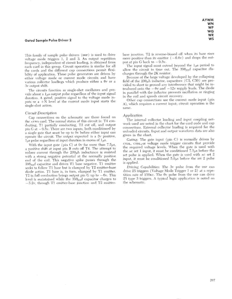

DSP: Driver, Sample Pulse. Same as D, with the additional function of supplying a specific length pulse output when the input consists of a gate and a sample pulse spike. The input may also be the output of a current switching circuit without a gate.
IBM Standard Modular System, Component Circuits, p206,207.
