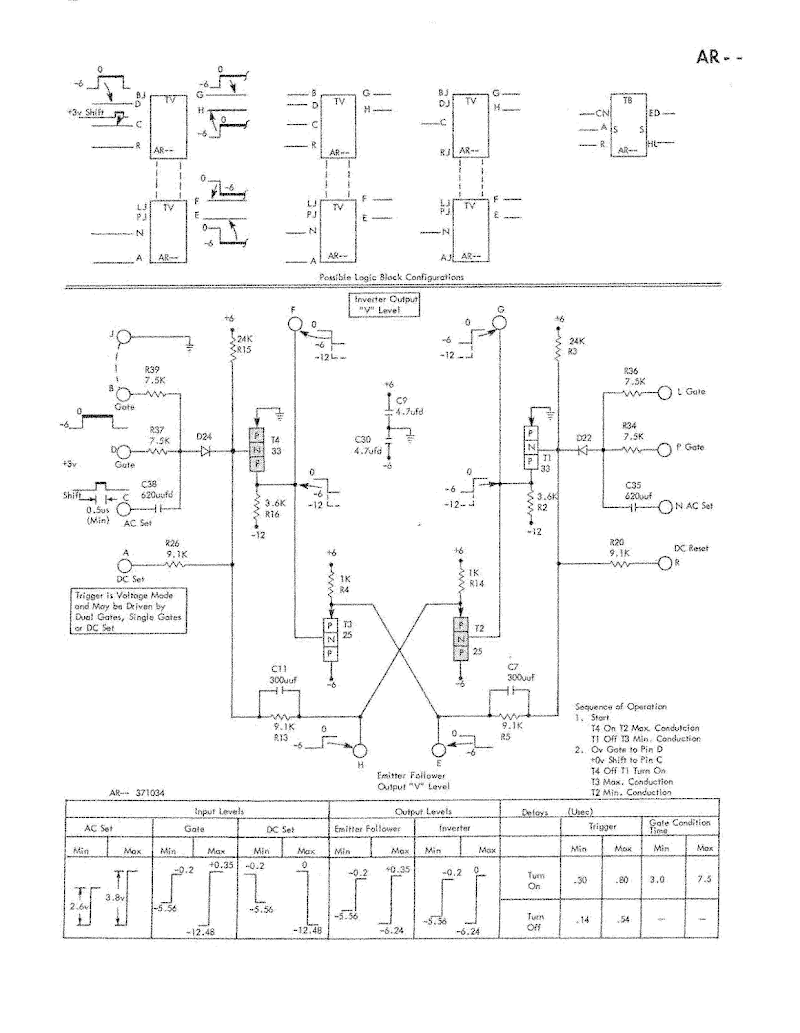

This page describes the IBM SMS card "AR", and is part of the SMS card database.
Voltage Mode Trigger 1
Part number:371034
Used in:IBM 729II/V
Symbol:TV
IBM Standard Modular System, Component Circuits, p202,203.
