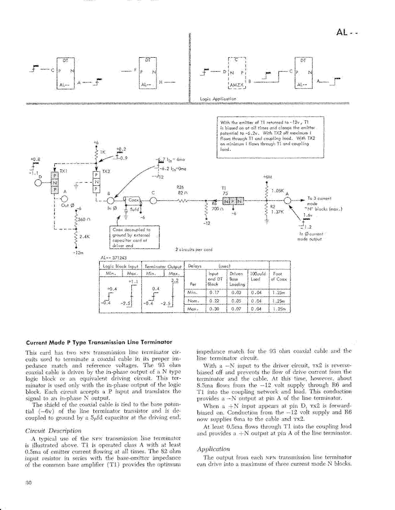

This page describes the IBM SMS card "AL", and is part of the SMS card database.
P Line Line Terminator
Part number:371243
Used in:IBM 7070,IBM 7090
Symbol:DT
DT: Driver. Terminator. A single-transistor class-A grounded-base amplifier used to terminate a transmission line.
IBM Standard Modular System, Component Circuits, p30.
