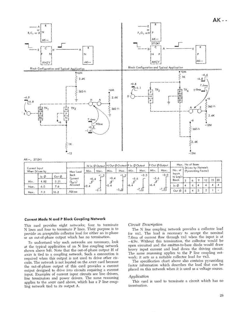

This page describes the IBM SMS card "AK", and is part of the SMS card database.
N and P Block Coupling Networks
Alloy coupling netwrks for n&p blcks
Germanium alloy transistors were an early type of transistor, faster than the earlier grown-junction transistors.
Part number:371241
Used in:IBM 1414 I/O Synchronizer,IBM 7070,IBM 7090,IBM 729V
Symbol:R
R: Load. Provides proper terminating impedance or optimum coupling of one circuit to another at the correct operating voltage level.
IBM Standard Modular System, Component Circuits, p29.
1414 SMS Cards, p54.
