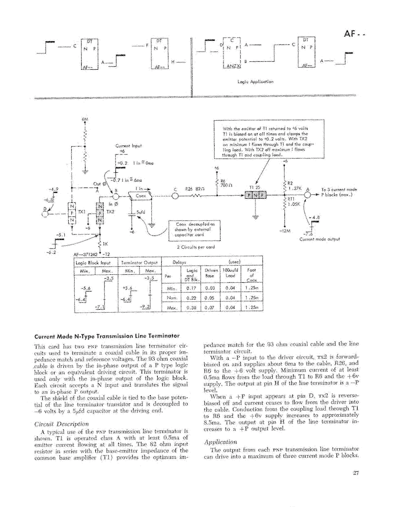

This page describes the IBM SMS card "AF", and is part of the SMS card database.
N Line Terminator
Part number:371242
Used in:IBM 7070,IBM 7090
Symbol:DT
DT: Driver. Terminator. A single-transistor class-A grounded-base amplifier used to terminate a transmission line.
IBM Standard Modular System, Component Circuits, p27.
