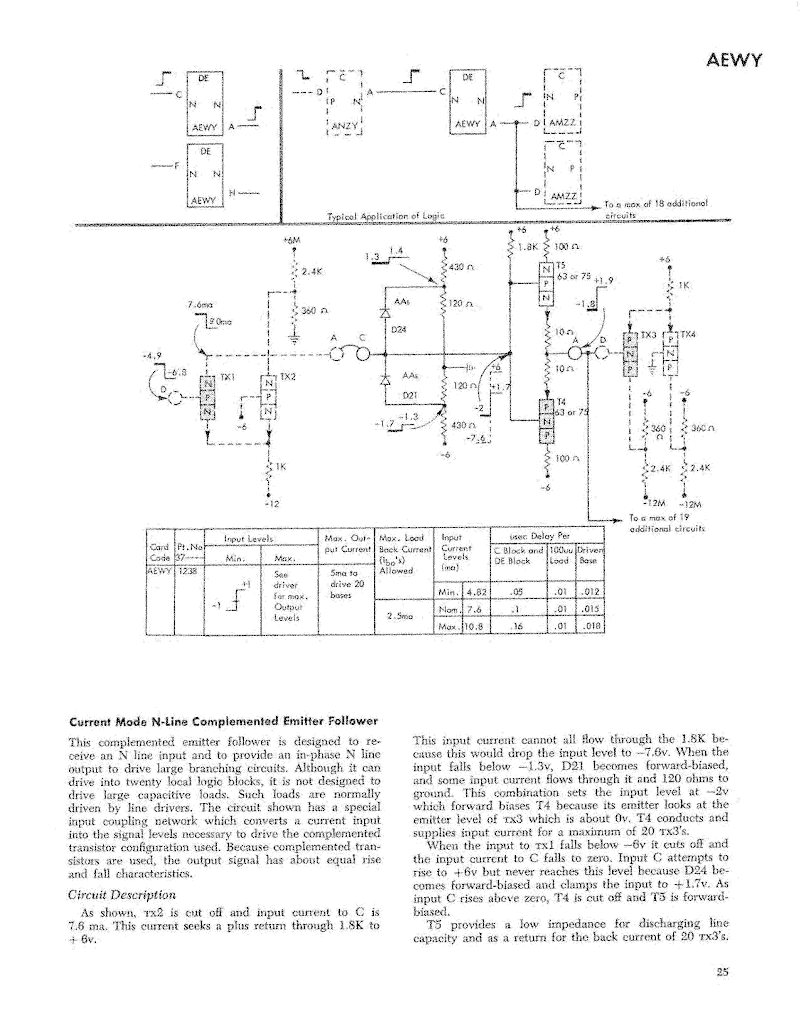

This page describes the IBM SMS card "AEWY", and is part of the SMS card database.
N Line Complemented Emitter Follower
Part number:371238
Used in:IBM 7070,IBM 7090,IBM 729II
Symbol:DE
DE: Driver Emitter Follower. A driver, operating on the emitter follower principle, used for power amplification, impedance matching, and isolation without inversion. Often used as a logical element.
IBM Standard Modular System, Component Circuits, p25.
