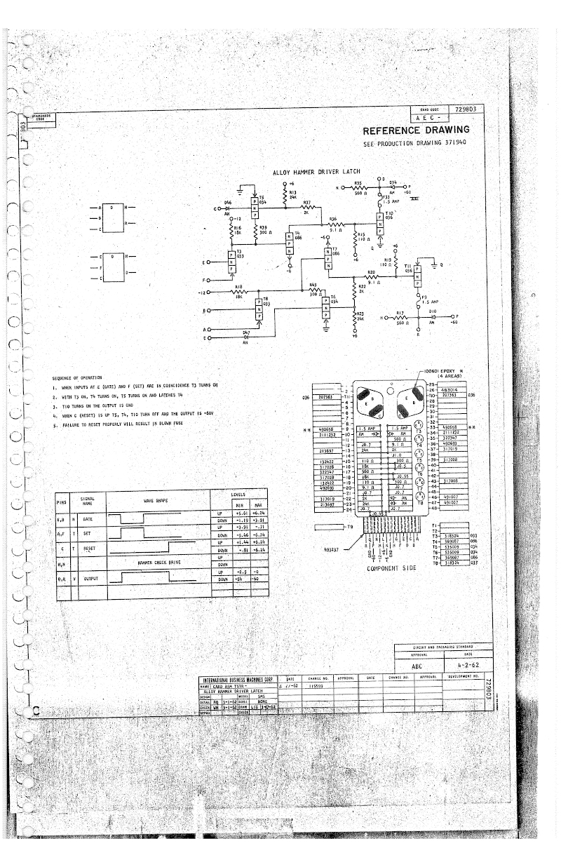

This page describes the IBM SMS card "AEC", and is part of the SMS card database.
Alloy-Hammer Driver Latch
Germanium alloy transistors were an early type of transistor, faster than the earlier grown-junction transistors.
Part number:371940
Field replacement part number:371940
Customer Eng reference number:729803
Used in:IBM 1401,IBM 1414 I/O Synchronizer,IBM 1410
1_2 SMS Cards, p58,59,60.
1410_SMS_VOL_1.pdf/1410_SMS_VOL_2.pdf, p2116.
1414 SMS Cards, p6.
