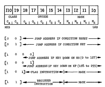

Each instruction is an 11 bit opcode, which comes from a ROM that has 320 11-bit words. The entire calculator software had to fit in this tiny ROM. An eleven bit instruction set seems very unusual, but it allows all instructions to fit into a single 11-bit word, avoiding multi-byte instructions. The first two bits of an instruction are the "class", selecting the type of instruction (arithmetic, flag, or branch). The next 5 bits select the specific instruction opcode. The final four bits select the mask and constant. The following drawing from the patent shows the structure:

The chip has a single condition bit. Depending on the instruction, this holds the status for key down, carry, borrow, equality, or zero. Most processors use separate condition flags for each type of condition. In contrast, t 0800 has a single flag and the programmer needs to keep track of what it holds. The condition flag is used to control conditional branches. There is no unconditional branch - the BET (branch every time) instruction is just a condition branch when the programmer knows the condition flag is clear. The top two class bits indicate a conditional branch, leaving 9 bits for the address. Thus, branch instructions fit in a single word, unlike most processors.
A few instructions don't have room for an opcode and branch address, so they use the same bits for both, which is very strange. The WAITNO
and WAITDK
instructions branch when a key is pressed. The bizarre thing about these instructions is that the opcode takes up most of the address bits, so there is little choice about where the branch ends up. The destination instruction is forced to go in a small area, even if that's in the middle of an unrelated block of code.
